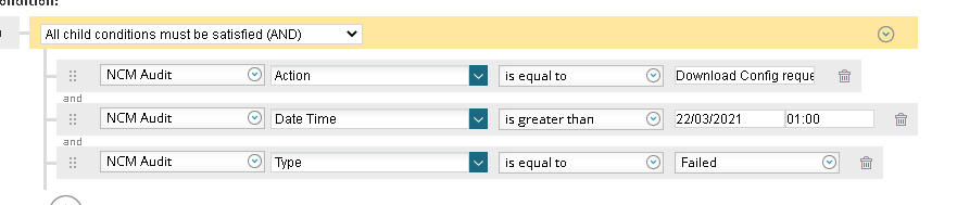

We have configured an 'alert' that essentially looks for and finds failed backup jobs. Ultimately this could just be a report but initial thoughts were to get it to alert on specific nodes failing to backup on schedule. In turn this would raise an incident. Either way, the logic we have so far is:
And this works quite nicely. The SWQL for this is:
