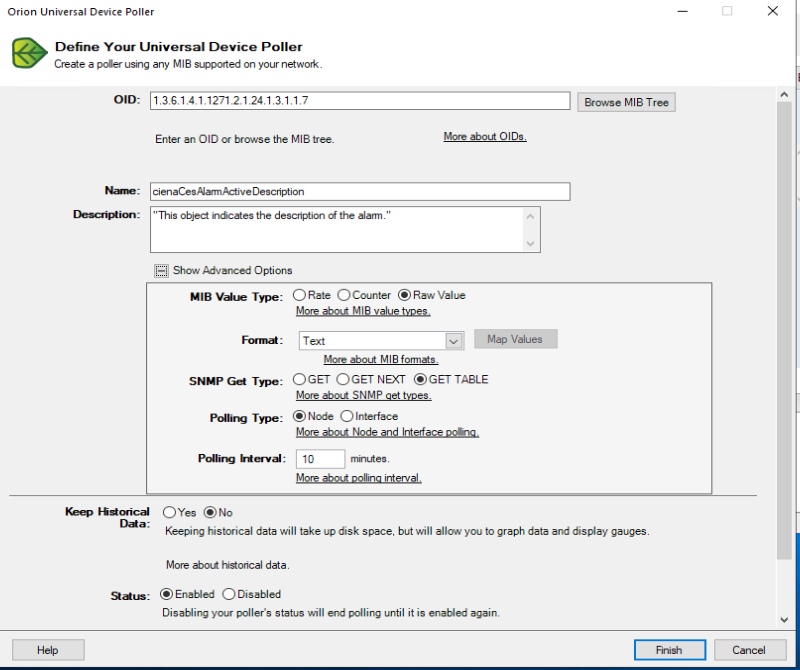

We're trying to poll for active alarms on a Ciena device. The poller itself works but when an alarm clears on the device the value polled doesn't clear from Orion. This causes issues with Orion alerts then not clearing unless you remove and reapply the poller. I'm not sure if its just how the device handles the alert table or if there's a work around in Orion? I did notice if there are no active alarms and I test the OID for the table it returns no OID supported. We're on NPM: 2020.2.4
Here's the poller we've setup:

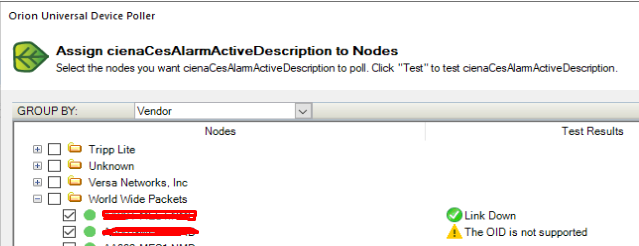

When doing a test this is one node with an alarm and one without:

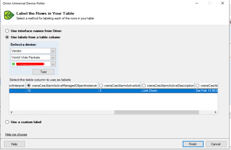

We used ObjectInstance for the label. In this case correlates to the port number.

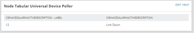

I used this chart to help troubleshoot. Any alarms will populate once its polled but when the alarm is cleared on the device it stays in the table until the poller is removed.

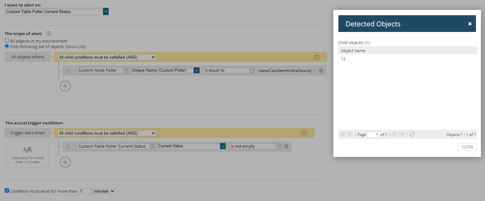

Here's the alert we setup. It seems to work its just the issue with the alarm values not clearing from Orion causing the alarm to stick unless the poller is removed and reapplied.
