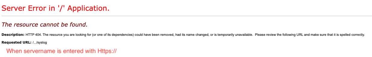

    Noticed something odd when I put it in to a custom query:
    Updated orion_server_name and,got an unexpected error.
    Changed the name to include https// solved part of that but not the whole thing.
    Wondering why the concat line did not work above. Any advice gratefully received.
    For now replaced that concat line with:
    ,'your_server_name/ui/orionlog/logviewer/now/1hours/0/syslog' AS _linkfor_Message
    Is it possible to get the hotlink to go to the SysLog View filtered on the device/message already, not just the unfiltered view?
  • Changed the link to:
    'your_server_name/.../LogEntryDetails.aspx +ToString(LogEntryID) AS [_linkfor_Message]
    seems to work, not in the browser so you can scroll up and down but opens up this event in a new window
