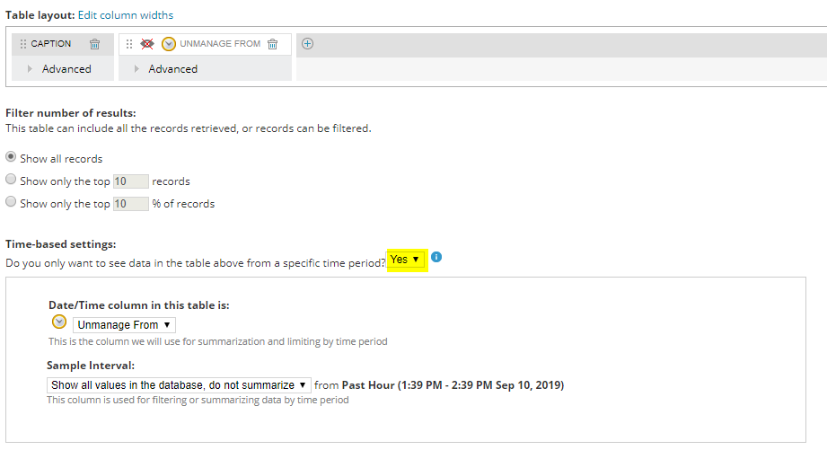

HI,
sure, you just need to toggle the 'Time-based settings' to 'Yes' this will then give you the desired output once you 'submit'

Add this work while putting the node in an unmanaged stated. The only issue I am having is using the event type to get a report that will show node unmanaged/decommissions for the past Xdays. I used the event type in another report which allowed me to arrange by past days/weeks/months. I want to do this with the process for historic information.
works but does not all the event time be an option to set a time frame for reports
