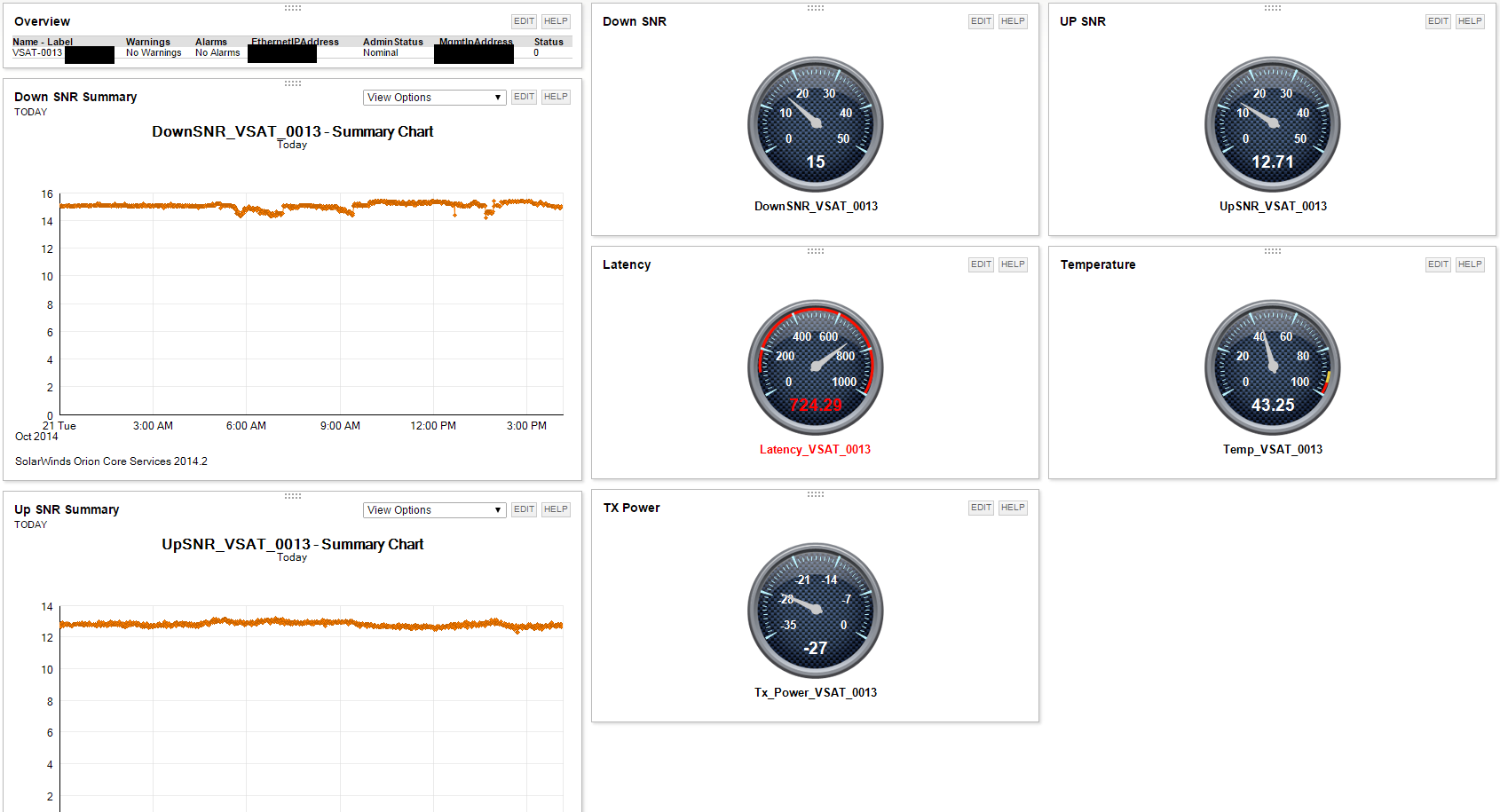

I'm working on setting up Idirect SNMP into SolarWinds now. I haven't attempted to pull too much data, but have been able to import SNRs, IP Traffic, Power, status, and a few other administrative values.
Are you able to pull these stats from individual remote modems?
Yes. It's actually a project that I have been working on for the last few days. I was able to pull full tables that covered all remotes in the NMS and was able to pull statistics for individual remotes.
There are tons of details that I am still working out, but it seems to be going in the right direction.
At first I was just pulling the full tables using different OIDs, for instance OID 1.3.6.1.4.1.13732.1.4.3.1.3 used with the GET TABLE option (Orion Universal Device Poller) would pull the TX power for all remotes. After performing a MIB walk on for the NMS server I found that each remote had an value that could be appended to the end of that OID and used with the GET option to pull just the TX power for the individual remote 1.3.6.1.4.1.13732.1.4.3.1.3.XXXXXXXX

Very impressive. I had set this aside for a while because I wasn't making any progress. Looks like you are on the right track. Are you building a custom poller for every parameter for every modem? That would be a problem for us since we have 500+ iDirect modems. Am I missing something here (again)?
I have been forced to build a custom poller for each Modem for each parameter. The network I am monitoring is fairly small, but still requires quiet a few individual pollers. I can pull entire tables and filter them into only the remotes I want displayed on that table using minimal pollers, however using that method I am unable to isolate individual remote parameters into gauges or graphs. I am attempting to find a way to pull an entire table with one poller and then filter it as needed into individual statistics, but haven't had any luck yet. I will be working on this project for the next few days and will let you know if I find an easier solution.
I am also working on the same type of project. Once the custom poller's are built you can see the data as a table if you use a tabular resource when you customize the view.
The problem is filtering it for each individual node, and requires associating the nodeid with the correct rowed inside the custompollerstatus table.
Let me know if you care to discuss this and maybe we can help each other out.
I think I may be on the same path. I have found that I can import an entire table and display it in a tabular resource. Since my last post I noticed that custom graphs could be used along with display filtering to isolate a single node within that table . This allowed me to have a graph associated with each remote while only using one custom poller. I would like to be able to use this method with gauges, but I haven't quite figured that one out yet.
