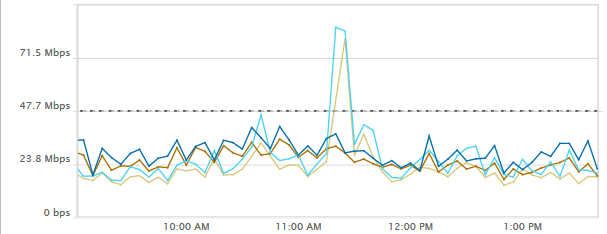

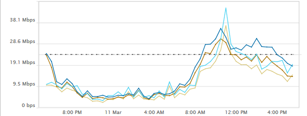

When the chart loads, peak receive for the entire time period is 44.7Mbps.
When I zoom in on that peak, peak receive changes to 85.1Mbps. Charts pasted below.
If peak receive is 85.1 at 11:15 AM, I would think I should see 85.1 whether I'm looking at a time span of 24 hours or 2 hours.
If the sample interval for peak receive is 1 day over a 1 day period, peak receive should be 85.1.
If the sample interval for peak receive is 1 hour over a 1 day period, there should be 24 peak receive values and 85.1 should be the biggest.
If you summarize data to a point where the metric name no longer applies, there should be some sort of indicator or message that tells the consumer they need to drill down to see actual peak.
From:
To:
