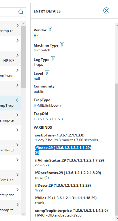

Im wondering if anyone can help me here with trapping SNMP events that will in turn trigger an alert within Orion.
1. I've already setup the traps which are showing within
- Alerts & Activity
- Traps
The problem is I cant seem to get the Trap / Rule to filter out the TrapOid = 1.3.6.1.6.3.1.1.5.3 and also for a specific Interface being down and send an email.
I can get the rule to fire when I only setup the rule to filter on the TrapOid 1.3.6.1.6.3.1.1.5.3
but wont work with the Varbind elemnet with OID filter applied...……. fIndex.29 (1.3.6.1.2.1.2.2.1.1.29) 29
So this would mean when interface 1/29 goes down fire the rule / email....
Below is the trap data im using to configure the rule

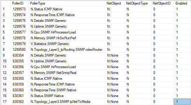

Below is the rule im trying to setup to only alert on interface 1/29 being down
