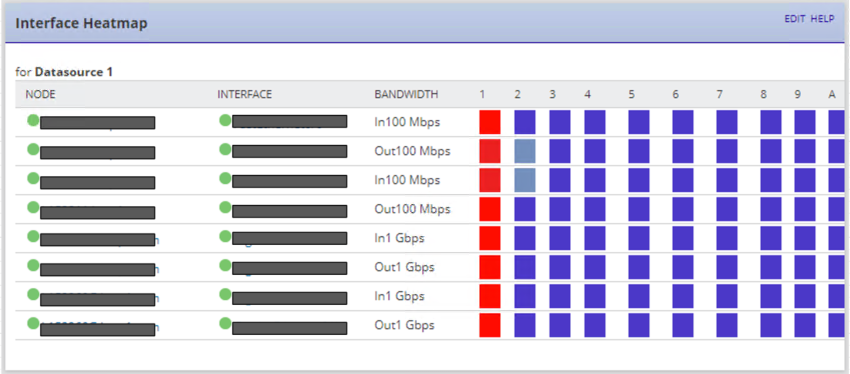

I have used this method to visualize the bandwidth usage. Getting the numbers are useful, but to ingest large amounts of information - can't beat a graphics.
For this example, there is a interface custom property called isWan (yes/no) to indicate that this an interesting interface. Once we know what we want to look at, we need to define what time period. The time period is defined in the set command (last week, last month, etc).
Now it's a simple matter of tallying the number of time the bandwidth is within certain ranges (0-10%, 10%-20%, etc). Since we know the number of sample, now it's a matter of just normalizing the data to the range (1-10).
In order to display the graphics, there are 10 graphics which needs to be created and put inside /Orion/images/statusicons/1.gif, 2.gif, etc.

Let me know if anyone has any questions on implementing this.
Thanks
Amit
