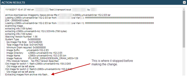

There is one other NCM limitation that you will need to keep in mind if you use a script like this to upgrade IOS devices in your environment. That second limitation is NCM will disconnect from the switch if there is no response after a short period of time. Anyone who has done an image upgrade on a switch stack before knows that this procedure can take some time. Lots of time, it’s 20 or 30 minutes, or possibly longer depending on the size of the stack. When this happens, you will receive a completed successfully message in the NCM ‘Transfer Status Screen’ however the upgrade is far from over as you can see in the scripts result window once you open it up.
A example of the script results window when NCM disconnects before end of upgrade is below.

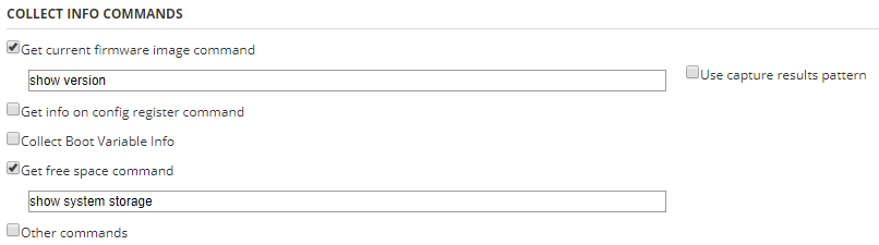

The work around is to max out the settings under the CLI. (The CLI settings can be found in All Settings -> Product Specific Settings -> CLI). I need to mention here that these settings ARE NOT recommended by SolarWinds and could potentially lead to other problems if left this way. Once the upgrade is complete these settings need to be restored to their original values. I have pasted a screen shot of the CLI settings below:…

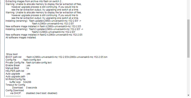

Now when the script below is run NCM will not disconnect early and the results are displayed more accurately in the ‘Transfer Status’ Page. A screen shot of the transfer status is pasted below when using the CLI settings above:…
With the screen shots above its easy to see what is missed when NCM disconnects too early. When NCM disconnects early the follow up commands are not executed. This includes the 'write mem' command at the end of the script. If jthe write mem command isn't executed then a reload of the switch could result in a failed upgrade of the stack.
