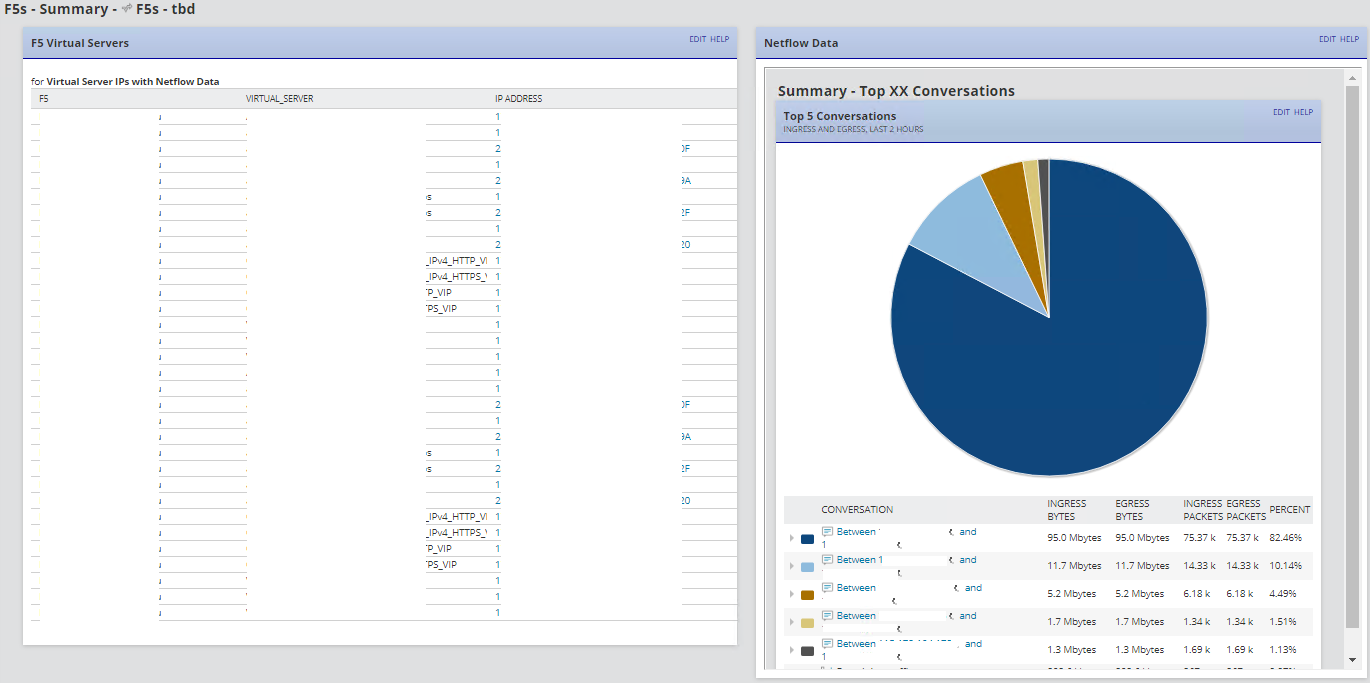

The second page is more a work in progress. On the left are all the virtual servers. Clicking on the right will show the Netflow conversations data.

Experimental - but fun - Section
Second Page - NetFlow Data
This is a work in progress. Uses an embedded IFRAME, and targeted links. I currently have it filtered to the subset of Virtual Servers that have NetFlow. If not filtered then there are too many rows of data. Note that I only have Virtual Server IPs. I could also do Pool Member IPs. I should also point out that I have the links loading Conversations. I would like to change this to also have a link for the Applications graph.
I cannot do a search like for other widgets, as I am using SQL so I can retrieve the IP address.
F5 Virtual Servers
This is a complicated query, as I have to do some advanced string handling that is really a bit beyond the SWQL functions. The IP links for IPAM are in the form aaabbbcccdddeeefff (for a.b.c.d IP addresses)
Table Layout:
| Column 1 | Column 2 | Column 3 |
| F5 | Virtual Server | IP Address |
| (None) | (None) | Allow HTML Tags: [Selected] |
NetFlow Data
Object Type: Custom HTML Widget
