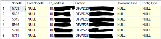

Here are the results of the report:
The key is the LEFT JOIN on line 9, pared with the [c].[CoreNodeID] in NULL on line 15. That's really all that's necessary here, the rest just shapes the data.
You can of course, change line 11 to represent a different Vendor, or multiple vendors by changing line 11 to be:
WHERE [n].[Vendor] in ('Cisco','Palo Alto Networks','Riverbed Technology') Lines 6, 7 and 10 are not useful for this report since they will always be Null since no config should exist if the node is not in NCM. However, the query can be modified easily to show recent configs (more on that later).
