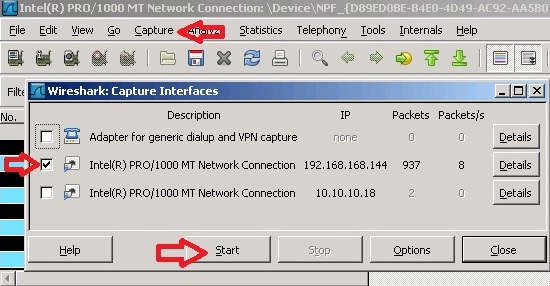

For this you will have to install the Wireshark as below.
Download Wireshark and install on Orion Server / Kiwi Syslog Server .
Wireshark · Download
Make Sure Windows / McAfee / Norton / Any other A/V Firewall Disabled on Orion Server / OR Create a Rule in Windows Firewall to allow port traffic in some cases i have found the Windows Firewall blocking the traffic to the service even the traffic can bee seen in the Wireshark

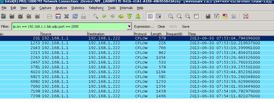

Click > Capture >Interfaces > Select "Required " Correct interface >
Now apply required filter.
Change the IP in filter of Node which is sending Netflow to Orion (Cisco / Juniper / Switch / Router ) and apply.
ip.src == 192.168.1.1 && udp.port == 2055
OR
udp.port == 2055
click apply .
Are you able to see Flows from the Node like (Cflow (for Cisco )/ Jflow for Juniper / Sflow ) ?
if no packet please check your device or network for further troubleshooting as this will confirm that
Orion is not receiving any packet hitting NTA default port 2055 .

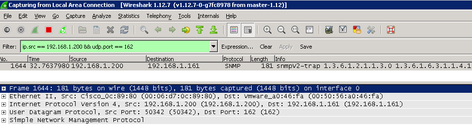

******************** Use following for Traps / Syslog filter in Wireshark as above example *************
For Traps
ip.src == 192.168.1.1 && udp.port ==162
OR
udp.port == 162

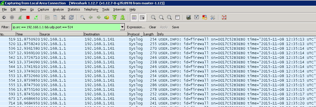

For Syslog
ip.src == 192.168.1.1 && udp.port == 514
OR
udp.port == 514
