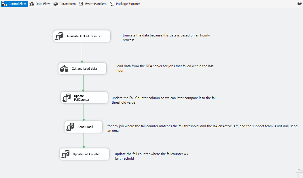

in Part 1, I showed you how to get the data needed to make an Enterprise SQL job manager using DPA. Now that it is out of the way, I will show you the inner workings to making this whole thing worth your while. The following is what the bulk of the work will look like
Truncate JobFailure in DB: pretty simply, don't want to repeat the same data every hour
code: truncate table dbo.JobFailure
Get and Load Data: pretty simply as well. it is a data task flow that goes to the dpa repository and pull it back any job failure within the last hour and store it in the destination database

Update FailCounter: exactly what it say, update the FailCounter

Send Email: this one has some logic to it.

Update Failed Counter:

That's pretty much it. This process can be expanded to track whether or not a job should of ran, whether a job should of been enabled but was disabled, run time duration, etc ...
