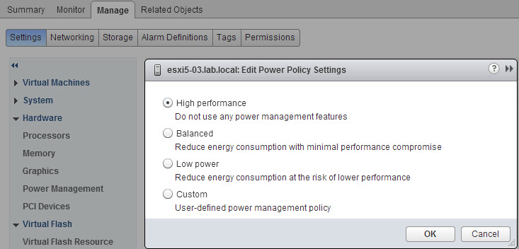

- Bios Settings - often new servers with newer CPUs from intel or AMD can be set to power saving, but High power is the only way to go! C-State increases latency too, even if saving energy, so if you're using latency sensitive application and you are chasing every single microsecond of latency in your environment, then you need to disable C-state. Also make sure that vSphere (ESXi) is set to high performance. Depending of your hardware manufacturer, you should check its documentation for best possible performance settings too.
