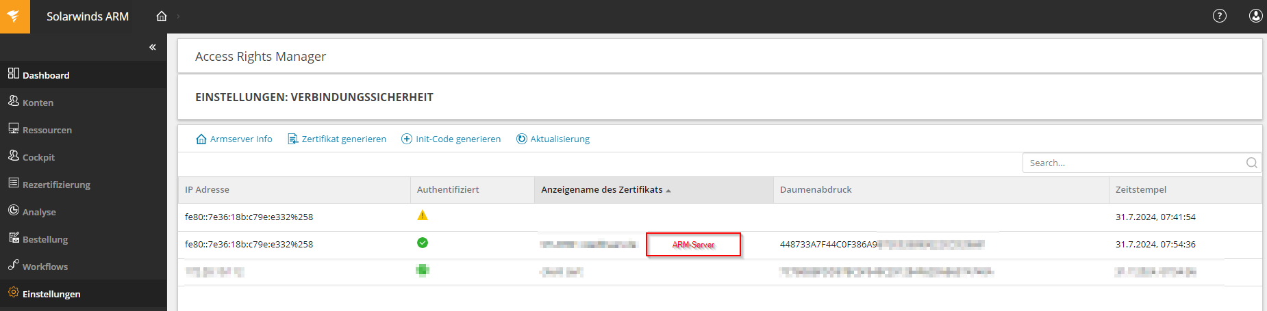

Its try ipv6? and this gRPC is the new certificate garbage. This error looks like the certificate is not available.
In the Webinterface i have the Server 2 Times.
Anyone a Idea? I open already a Ticket.
My template Work find without script. I already create a simple script but it dont work ether. I guess this certificates make it very worse.
