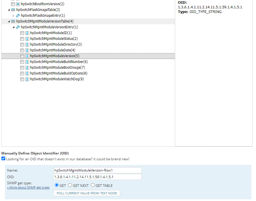

Following, because I have the same issue. I think you're on the right track - I think we can essentially extend the MIB to find the answers we're looking for. I had to do something similar for another project where I was trying to track some HPE fiber port info:
https://www.solarwinds.com/documentation/en/flarehelp/npm/npm_2022-3/content/core-duplicating-an-existing-poller-sw344.htm
and
https://www.solarwinds.com/documentation/en/flarehelp/npm/npm_2022-3/content/core-creating-universal-device-pollers-sw551.htm
Select the MIB table you need
Check "Looking for an OID"
Add a custom name
Use the existing Table MIB - and update the ".#" with the row number
Select "Get"
Example:
