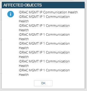

When you configure an Alert (Alert Definition) on the Summary page, you have an ability to "Show list" of components that would trigger an Alert (unless Alerts are Muted) if you save the Alert configuration. With SAM Alerts, the "Show list" option is not very helpful since it lists the Component Monitor name which would be the same on all Nodes using that Component Monitor. Here is an example:
Note that all of the above, with the exception of the first one, have the exact same name so you cannot tell which of the Nodes the Components are related to. Simply not enough information there to make this helpful other than the fact that you know something might trigger an Alert if the Alert configuration is saved. Thanks SolarWinds!!!

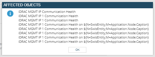

To try to work around this, I tried adding ${N=SwisEntity;M=Application.Node.Caption}, ${N=SwisEntity;M=Caption}, ${NodeName} or ${Caption} to the name but these variables won't resolve to a Node Name:
Note that in the above, I currently have two Application Monitors with similar Component Monitor names as I am converting from old to new and that is why the "Caption" variable is only showing for some of them.
