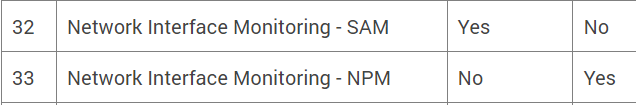

With the agent installed you need to use SAM to monitor the network interfaces to this level. With SNMP its NPM.
https://support.solarwinds.com/SuccessCenter/s/article/Comparison-of-Linux-agent-versus-agentless?language=en_US

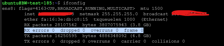

So I guess its worth running list resources on a linux node with the agent installed to see if you can capture the metrics you need.
Here is one of my SNMP nodes :
Does it now show up the same if you run the Linux agent? I'm trying to get them to install the agents for Linux and this would be a consideration for us but as we run both SAM and NPM it won't be a big deal.
