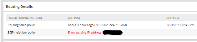

Trying to resolve this issue. but not having much luck finding anything online. This is happening on all FortiGate devices. Appreciate any help if someone has come across this issue before. Thanks

SW support informed me that the Forigate devices showing the error are not on the support device list.
I did create a Undp, I used OID '1.3.6.1.2.1.15.3.1.2' which is "The BGP peer connection state.". But the alerting will not pick up a value for the 'BGPPEERSTATE' which I had set and 'Not equals 6'.
We got this working by setting traps on the device when a BGP is in idle and set the alert in SW. Hope that helps
Hi Rocco, thought you may also be interested in using this IOD 1.3.6.1.2.1.15.3.1.16 pls check it out and let me know your thoughts
Thanks Rajpad. I did use that OID for display purposes for the network team to view time established. I guess you could create an Alert for a condition that fits your environment.
