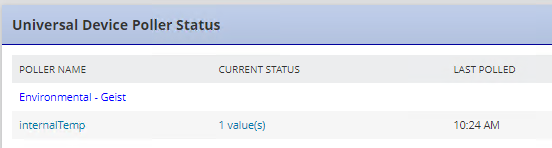

Setting up a Geist Watchdog 15-P NPS that is an environmental monitor with temperature, humidity, and dewpoint. Focusing on the temperature first, I was able to create a undp using 1.3.6.1.4.1.21239.5.1.2.1.5 for the internal temp. but it only works as a table. When viewed in solarwinds instead of the actual value, I get "1 value(s)". This is very different that the other undp's I have setup. From the snmpwalk here is the row I am targeting. It is shown in tenths. I can transform later.

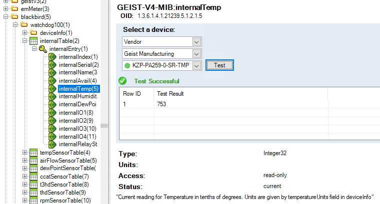

1.3.6.1.4.1.21239.5.1.2.1.5.1 = INTEGER: 753
When I test with the Orion Universal Poller, it's successful.
But in SolarWinds, I get this
