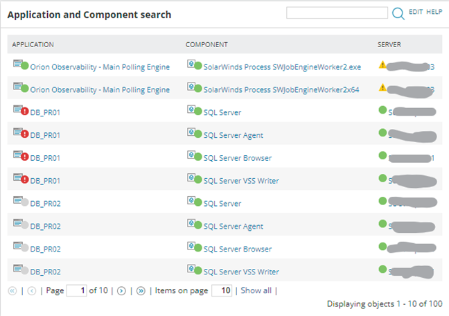

How to use this en real life? Lets test it with below script. A script for a Custom Query widget that displays all applications, components and nodes with correct status icons. Uncomment the last line when used in the search query and you get a widget where you easy and fast can search for all components and applications.
SELECT
A.Name AS [Application]
,A.Components.Name AS [Component]
,A.Node.Caption AS [Server]
--- Links and icons
,A.DetailsUrl AS [_LinkFor_Application]
,A.Components.DetailsUrl AS [_LinkFor_Component]
,A.Node.DetailsUrl AS [_LinkFor_Server]
,CONCAT('/Orion/StatusIcon.ashx?entity=Orion.APM.Application&status=',A.Status) AS [_IconFor_Application]
,CONCAT('/Orion/StatusIcon.ashx?entity=Orion.APM.Component&status=',A.Components.Status) AS [_IconFor_Component]
,CONCAT('/Orion/StatusIcon.ashx?entity=Orion.Nodes&status=',A.Node.Status) AS [_IconFor_Server]
FROM ORION.APM.Application AS A
WHERE
A.Components.Status!=27
--AND (A.Name LIKE '%${SEARCH_STRING}%' OR A.Components.Name LIKE '%${SEARCH_STRING}%' OR A.Node.Caption LIKE '%${SEARCH_STRING}%')
