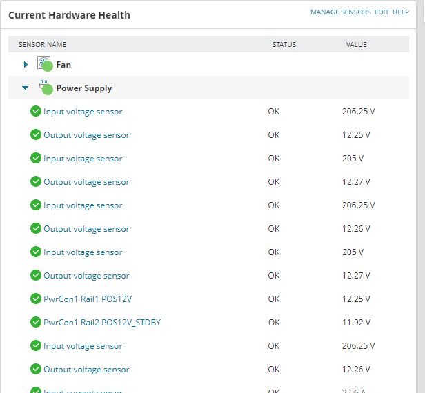

Has anyone been able to show Arista power supply up down status? I've been going back and forth with SW and Arista support. Right now we are seeing this:
Arista have given the following OID .1.3.6.1.2.1.131.1.1.1.3.100711000 and confirmed on the switch itself:

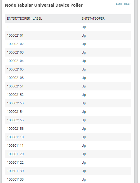

When I run an SNMP walk from the our main server with that specific OID it does not find the OID but when I run a shorter version such as .1.3.6.1.2.1.131.1.1.1.3, the more specific OID is found in the walk.
When testing the specific OID with UDP it says OID is not supported. I'm able to use the shorter OID and get a list like this which includes the more specific. Anyway to only show the specific OID in the widget and change the 100711000 to say Power Supply?
