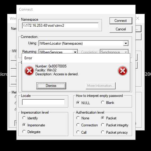

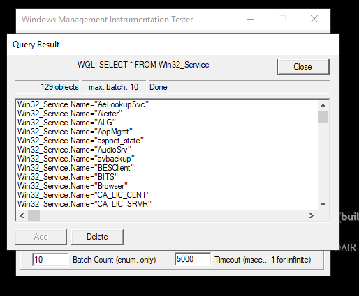

When I log into the server and run wbemtest to the nodes failing, it fails, but it goes through just fine on the one connecting:

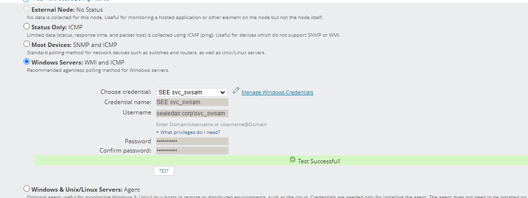

Node from above that is connecting through the web console showing 'Test Successful':

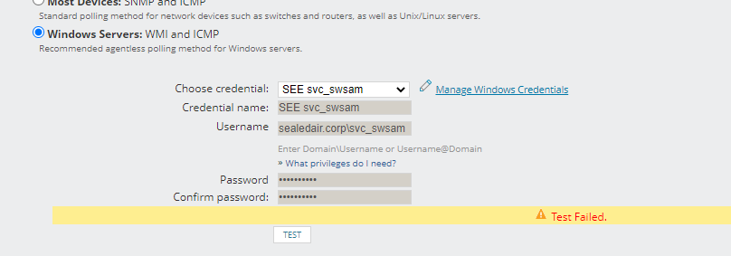

Node showing Test Failed:

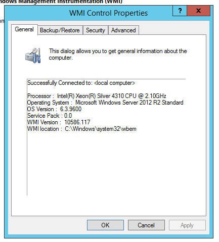

If I check the WMI service on the example server that is failing above, it's up and working:
