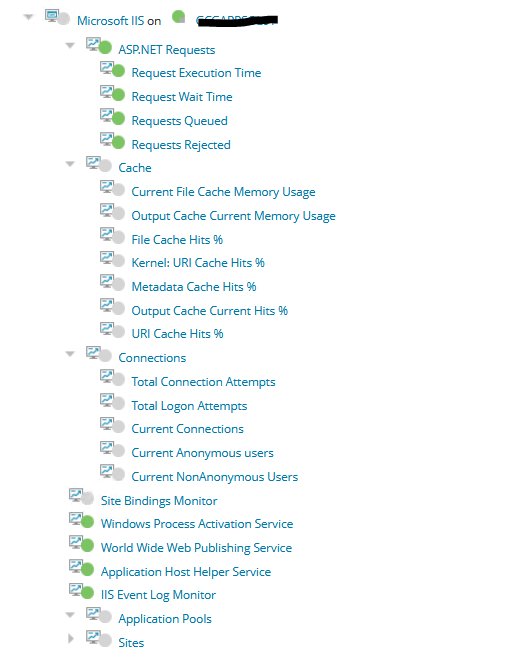

Hello Everyone,
We have four instances of AppInsight for IIS installed, and three are monitoring correctly. The fourth, however, returns the result you see below with many unknown components. All use 'Inherit Credentials from Node, and the credentials test passes, as does the 'Configure this node for IIS. About the only thing different is that the problem instance of IIS is on the Orion Server; it is the SolarWinds website. The SolarWinds node is monitored with WMI like all the others.
I have tried deleting this application monitor and adding again from the 'List Resource' on the Orion server. I see the error 'Connecting to remote server x.x.x.x failed with the following error message: Access is denied.'
Any ideas?
