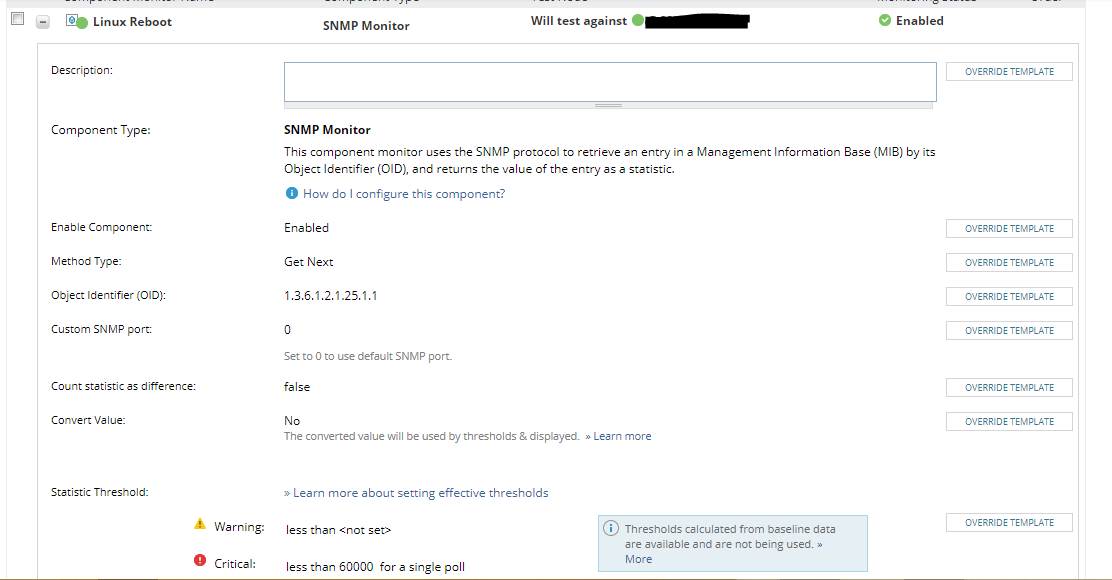

Process For SAM Configuration:
1. Go to Application Manage Template > Create New Template > Add Component Monitors > Manually Add Component Monitors
2. Select SNMP Monitor
3. Fill the data in the below format:
3.1 In this, the OID that we will provide is "1.3.6.1.2.1.25.1.1" which provides the information of HOST-RESOURCES-MIB::hrSystemUptime.
3.2 The Custom SNMP port needs to be 0 in case we need to use the default port ( In case of any other port, kindly mention the same)
3.3 The Statistic Threshold needs to be set at Critical with value Less Than 60000 (this is because, 60000 means 10 min, i.e as and when the server comes up and SAM polls the data, if the system uptime is less than 10 min, the status of application with change to critical) (This configuration is good for me because I am polling SAM application data every 5 min, it may vary with different environment).
4. Create the template and start assigning the nodes to the same. (We can create a dynamic group and assign that group to this template so that manually not every linux server needs to be added in the template).

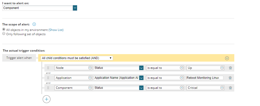

Process For Alert Configuration:
1. Go to manage alerts and create new alert.
2. In trigger condition, use the below configuration:
3. In alert action, you can perform any sort actions as per your requirement.
