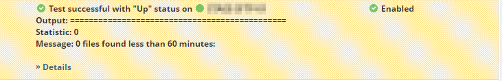

I was able to download from Thwack a file age monitor template that was looking for files older than a specific time. I updated the PowerShell script so it looks for files less than a specific time but I think I am missing some additional information in the PS script or I just do not know how to alert on a statistic.
When a file is found that is less than 60 mins old I get this output.
When no file is found that is less than 60 mins old I get this output. I was going to try and setup the alert for up/down but I am not sure what else I need to change in the script So I was going to try and setup an alert based on the statistic. I have tried a few different alerts but they do not work correctly.
Here is the script hopefully I am not too far off on this at all. I am a PS novice and this is the first PS monitor I am working on for Orion. Thanks! Dave
