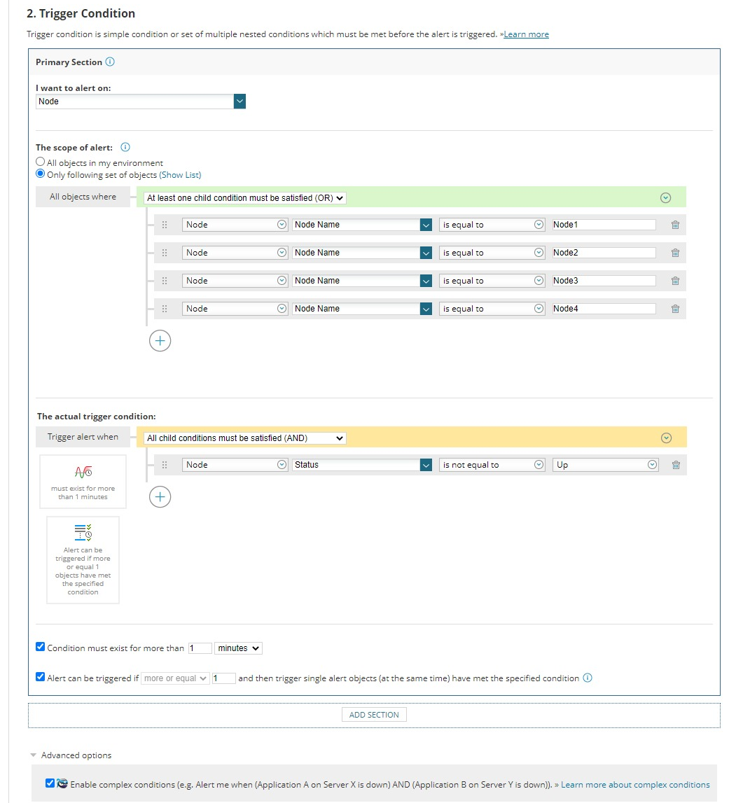

I think I have only used the "Alert can be triggered if" once in the past and now I am wondering if that one is working. Let me lay out a basic scenario and explain what I am seeing.
The Goal:
Trigger a single Alert if any or all of the Nodes are not responding to Orion.
The Configuration :
Outcome:
If 1 of the 4 Nodes is not responding, no Alert triggers.
If 2, 3 or 4 Nodes are down, Alert will trigger stating "1 Node" caused the trigger.
Question 1:
The "Alert can be triggered if more or equal 1 and then trigger single alert objects (at the same time) have met the specified condition". Why does the Alert not trigger if only 1 of the 4 Nodes is down?
Question 2:
Why, if 4 Nodes are down, does the Alert trigger stating that "4 Nodes" caused the trigger?
I also tried the same testing with SAM Component monitors and the behavior is different but still wrong. If it is 4 Component Monitors in the Alert Rule rather than 4 Nodes in the Alert Rule:
if 1 or the 4 Components down, the Alert will not trigger,
if 2 of the 4 Components are down Alert will trigger stating 1 Component caused the trigger
if 3 of the 4 Components are down Alert will trigger stating 2 Components caused the trigger
if 4 or 4 Components are down Alert will trigger stating 3 Components caused the trigger.
Why is it always 1 short of reality?
THANKS
