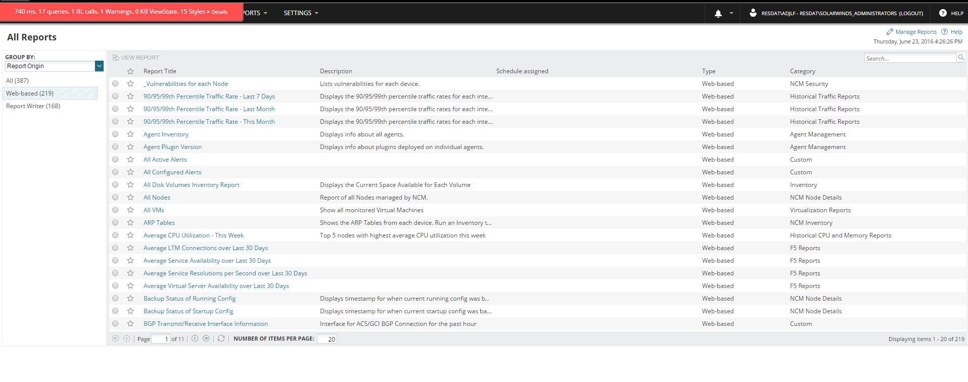

The message seen in the capture shows that the new menu gets covered, if you're on a page where you can scroll down the menu will follow you and you can access it again, however if you can't scroll down you can't access the menu to navigate away.
that looks like the "HUBBLE" debug header.

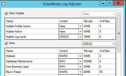

go into web server and search for "LogAdjuster" application name.
Ensure "Hubble Active" is False.
That was it. Thank you for the fix!
