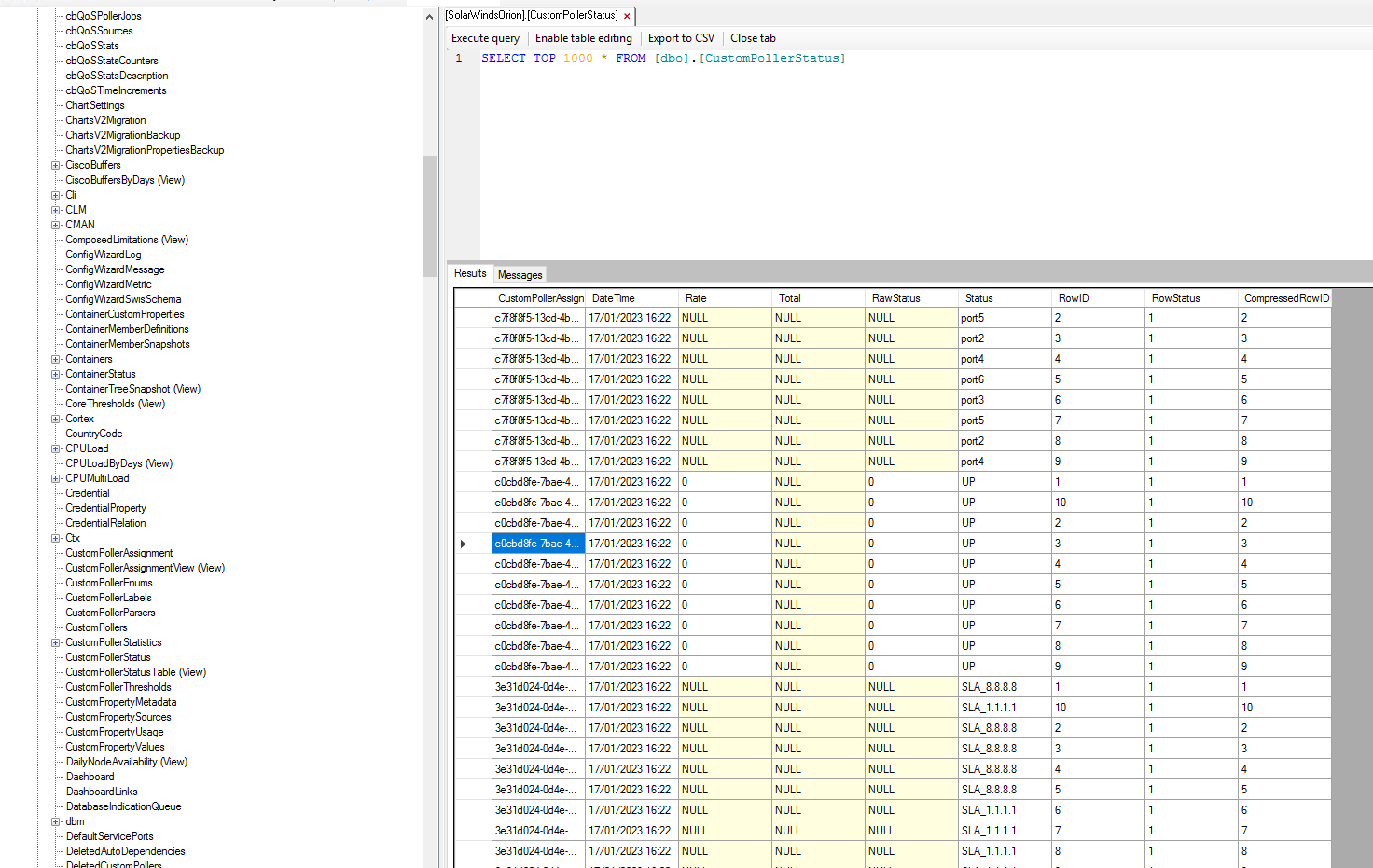

I see this on the database manager:
So I see all the values that I extract in the Status column...

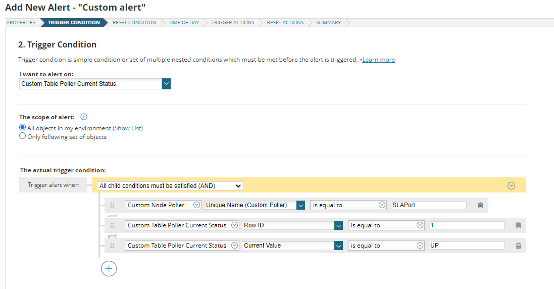

Now I'm trying to create a custom alert but I need to merge the data, for example If "SLA_8.8.8.8" and "port3" and is "DOWN" generate an alert... This is what I do but I don't think it works:
Are there any detailed guides on how to do this? What am I doing wrong? is it possible to cross-reference the three snmp queries?
