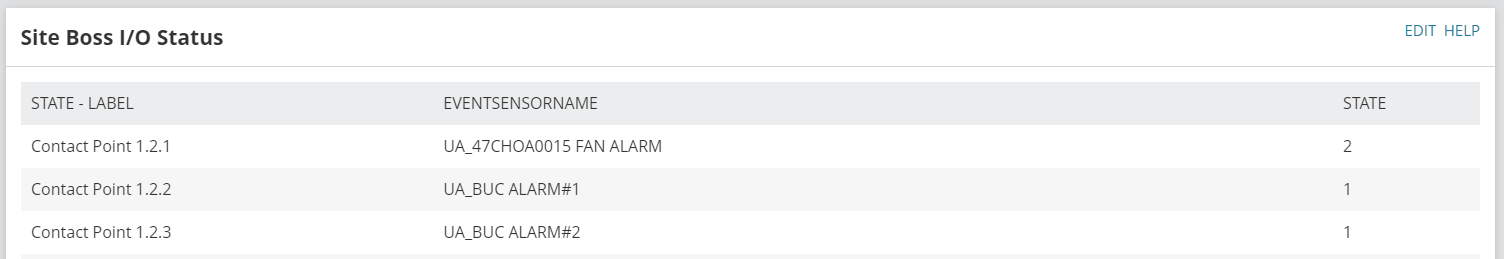

So, my company uses an RTU which collects binary inputs from multiple devices connected to it and uses that to signify when the connected systems are in alarm. When their binary state changes it triggers a preset alarm. The following is the custom Poller table on the node which contains the alarms and which physical I/O ports they're related to.
_____________________________________________________________________________
So basically, if contact point 1.2.1 is high then the alarm triggers. (A state of 2 is high 1 is low, idk why it's not 1 and 0)
