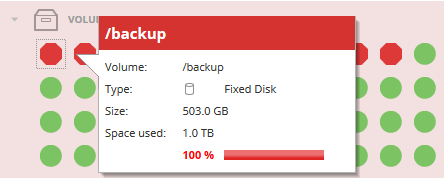

As you can see to the previous screenshot the /backup are at 100% and reporting a maximum partition size of 503.0 GB but per checking directly on the database server it shows:
A recent upgrade in the database server's file system was performed where the disk /backup was upgraded from 503.6 GB to 4.5 TB.
Solarwinds didn't notice the changes in disk capacity.
If you click the /backup you will be directed to this view:
Percentage used is 206%. The reason why it happened is because the 'size' is not updated (it should be 4.5 TB).
If the current 'space used' increases and 'size' remains not updated, the 'percentage used' will no longer reliable.

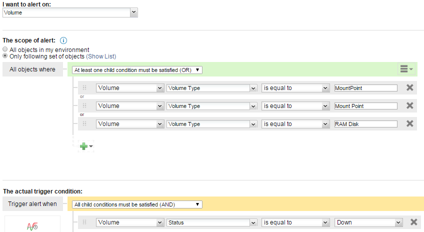

Mount Points Monitoring
If you would like to know how Solarwinds will monitor if server resources is added or removed to the server which is already in the monitoring, please refer below:
1. If any mount point is removed you can configure (volume down) alert for the same.
You will be notified with volume is down. Below must be triggered condition for volume down alert or you can make changes according to the requirement.
2. If server has a new resources or upgrades.
You need to list resource every time and add them under monitoring.
