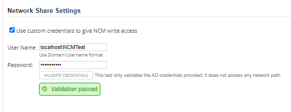

Step 2 Provide NCM credentials for the share. KB https://documentation.solarwinds.com/en/success_center/ncm/content/ncm-write-access-network-share.htm
Within settings you will go to NCM Settings --- Advanced Settings
Click on the box that says use custom credentials to give NCM Write Access and it should open up with a prompt to enter creds (If for any reason you don't get the prompt for credentials click the box and then submit the page should give an error and the boxes will be there)
Enter your credentials and hit validate to ensure they pass.
Special note only for LOCAL ACCOUNTS as I'm using in the example above you will also need to create that exact same user/pass on the Orion server. If you are using Domain Credentials this isn't required

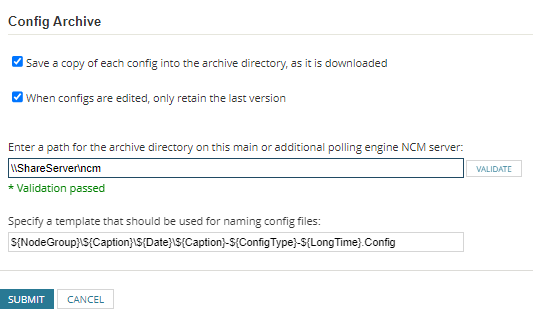

Step 3: Point your config archive to the share in question. Within Settings you will go to NCM Settings -- Config Archive Folder Location
Enter your network share path (Be sure to use the proper format \\ServerName\ShareName) and validate that NCM can access.
Step 4: Kick off a device backup and then confirm the files were placed in the share
