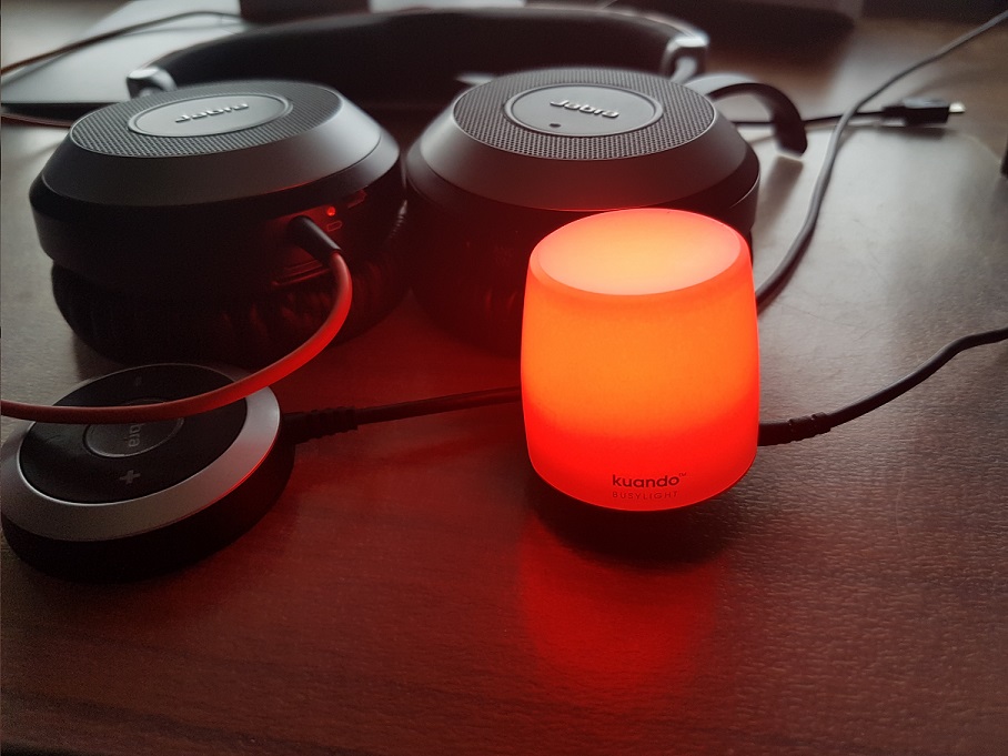

Busylight alongside Jabra headset for perspective

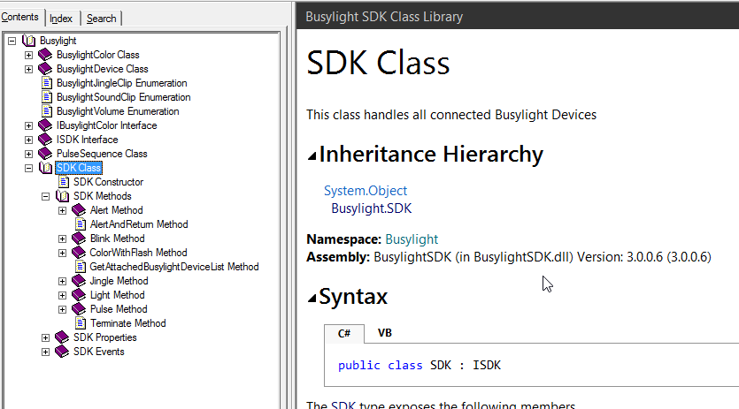

. 3.0.0.6), and while it ships with C++, C#, and VB code samples, a really strong feature of PowerShell is that it’s easy to expand its reach by using objects designed for other technologies. I'm not going to do a huge amount of coding today, but just for a quick proof of concept, I want to very quickly just do something basic—like setting the color to blue—from PowerShell. Once I download and install the SDK, the next step is to look at the included help file documentation, and I note there are a few classes: busylightcolor, busylightdevice, PulseSequence, and SDK. That might be of interest.
Busylight SDK Help
At this stage, don't panic if you don't know what constructors, methods, and properties are; I'll explain as we go along. In my case, I'm fortunate that I also have a basic understanding of some programming concepts—I've worked with C, C++, and Java
, as well as various VB & FoxPro applications I developed in previous roles—but the key thing I noted that in the "SDK" class is that it is described as “This class handles all connected Busylight Devices,” so it seems like a good place to start.

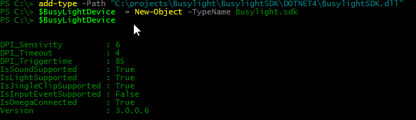

1. I'll load the DLL, so that PowerShell knows what code I want to use (the "add-type" line)
2. Next I'll create a new object, which from the documentation, is in a namespace called "Busylight" (tab-completion will help!), and I assign this to a $BusyLightDevice variable. (Just in case you're interested, at this stage the "constructor" that you see is called implicitly, so you don't have to worry about it)
3. And finally, I'll just now check the variable, to make sure it's connected, and sure enough we're now seeing info.

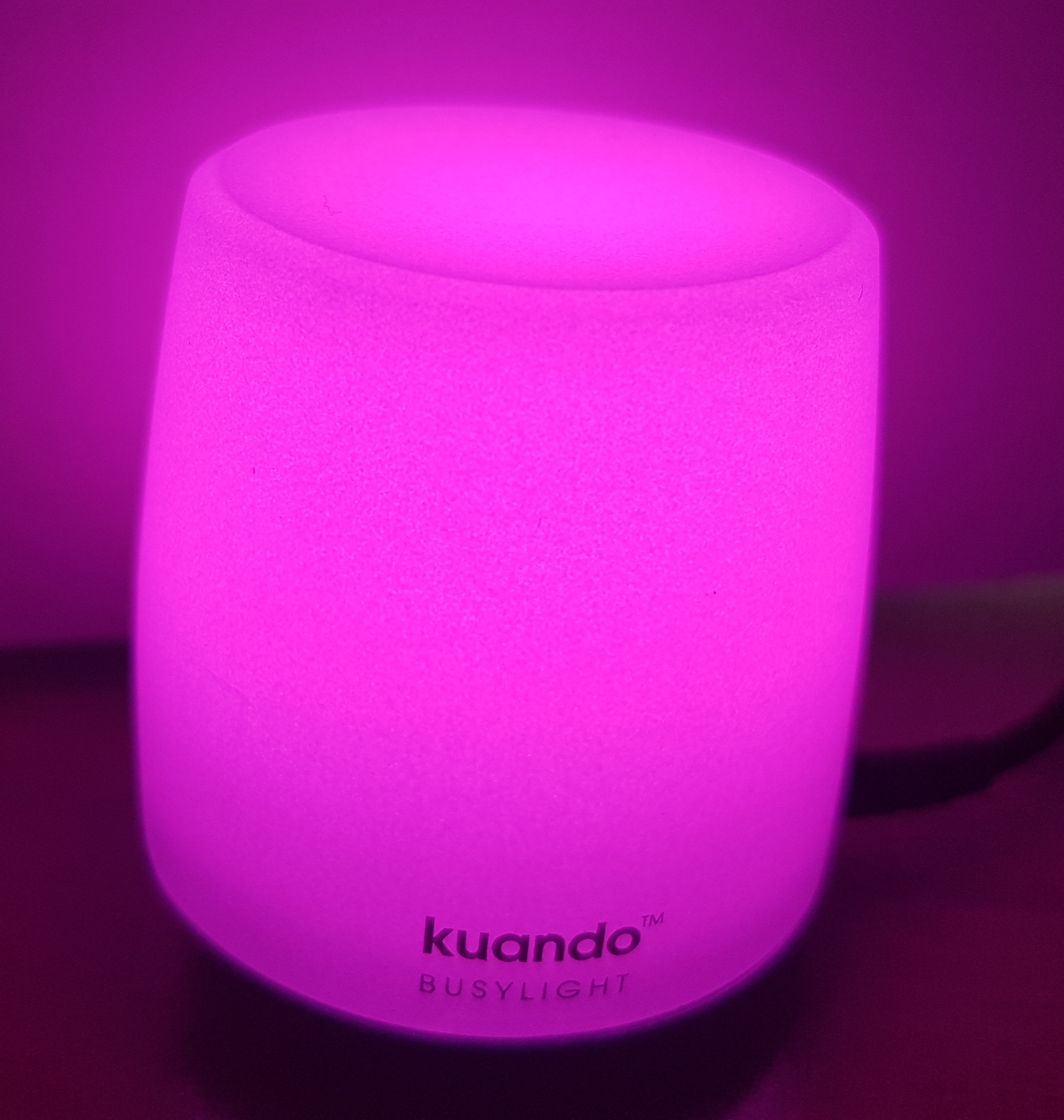

By setting the different red, green, and blue combinations as RGB values we can now set different colors. So if I now add in red, and check the settings:
And as we can now see, we have a purple!
