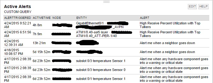

I don't know about you, but I really don't like the new Active Alerts view they created in NPM 11.5, to replace the old one they had since I started using Orion NPM. It only show 5 at a time, and you cannot sort it with the latest on the top. I like to see the newest alerts at the top of that view. So I created a Custom Query view to replicate the old view. I took the SWQL code from the All+Active+Alerts.xml script in NPM 11.5 RC4 Active Alerts and modified it a little and then put it into a Custom Query and added to the Summary page.
This is what it looks like:
Here is the code to insert in the SWQL box:
