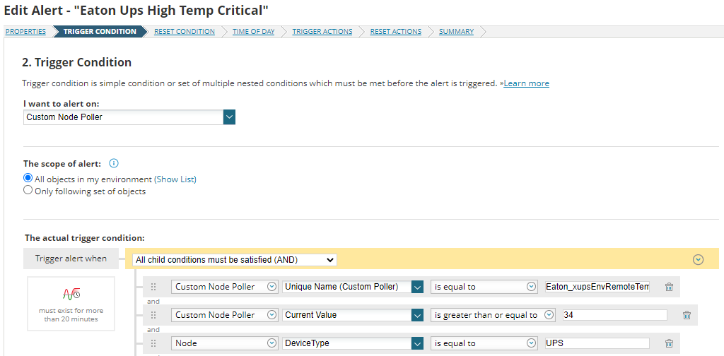

We have a custom alert for Eaton UPSs that checks the current temperature. If the current temperature is above a certain value, the alert will send an email. However the alert is triggering on temperatures much lower than the thresholds.
The alert is being triggered on temperatures that are lower than 12C. I confirmed that the UPSs are using Celsius as the measurement metric. Any thoughts why this alert is triggering?
