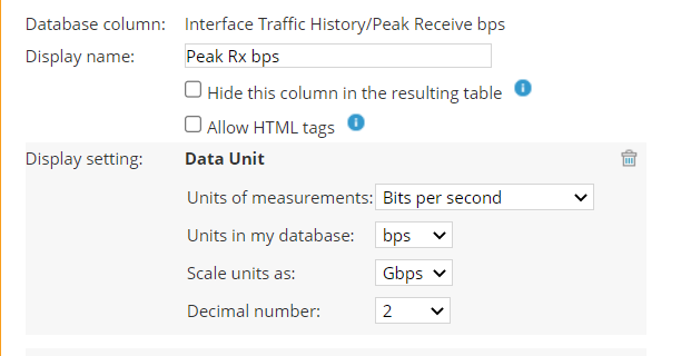

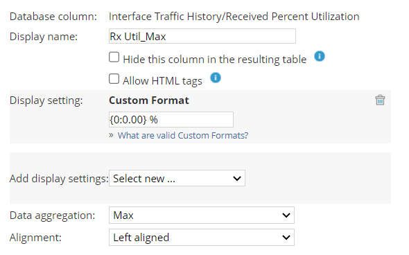

Built Weekly Interface Utilization Report which is set to run for previous 7 days and provide output. The report runs successfully however it returns with two sequential timestamps for each interfaces. The majority of records are close in RX Util (MAX) and TX Util (Max) but there are a some where the difference in utilization from both timestamp records is greater that 10%.

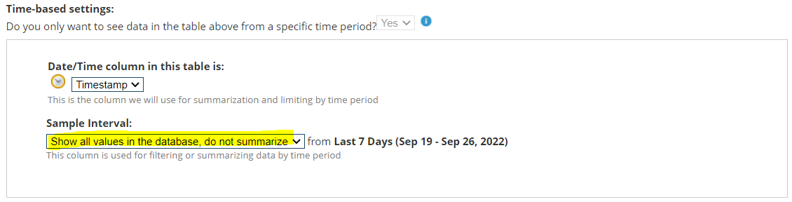

I have tried to change the sample interval to "show all values in database, do not summarize" from last 7 days and it did produce one record for each interface which was correct based on my review of some usage graphs. The report no longer runs and only produces an error at this point.
Newer to SolarWinds and uncertain where things may be going wrong two timestamps for each interface and ensuring the collection units are setup correctly.
Any guidance on setting up a Interface report to show max (TX & RX) utilization in a single record for the week interval would be appreciated. I have tried many methods to attempt to correct without success. Some element of the report structure is not happy and functioning.
