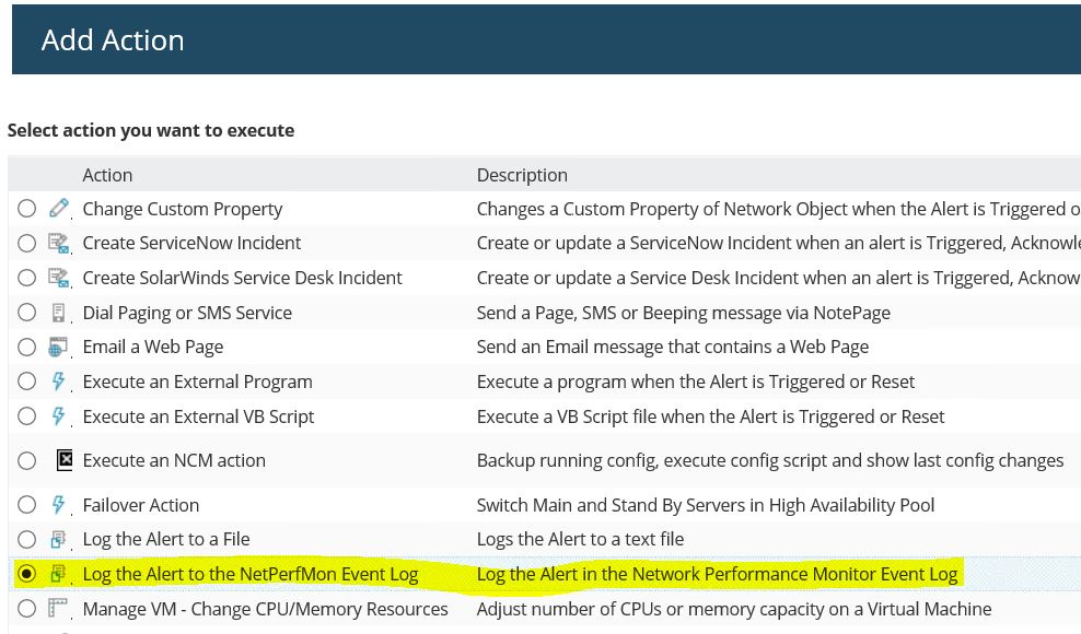

We are using the NetPerfmon log option. So ServiceNow scraps the events in SolarWinds. Certain Fields are mapped across from SolarWinds in to ServiceNow. This in turn creates the Incidents and from the action you see below certain variables within this will populate a number of fields such as Short description/ main description etc.

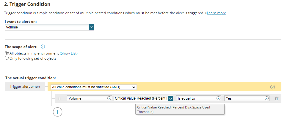

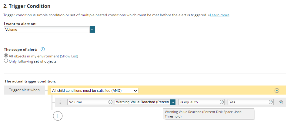

Example Alert we are testing
Volume Alert
1. SolarWinds P3 Warning Alert created.
2. ServiceNow Incident created.
3 SolarWinds P2 Critical Alert Created.
4. ServiceNow ticket updated.
(So Far all works)
5. Engineer fixes the P2 critical Volume issue. SolarWinds P2 Critical Alert closes,but so does the Incident.
(This still leaves the warning SolarWinds Alert open. Meaning we could have stale alerts left open and worse preventing further alerts not being created until these have been cleared).

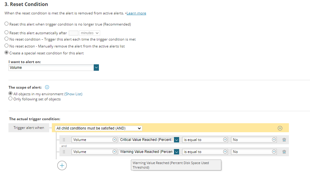

We initially tried to put a trigger/reset action but this failed. After looking at this further we could see each of the alerts create in Solarwinds have different Event ID's.
Hopefully you can see better with example below.
