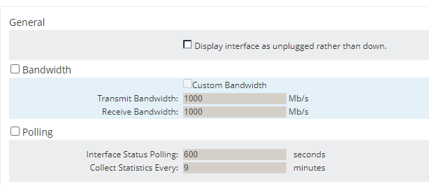

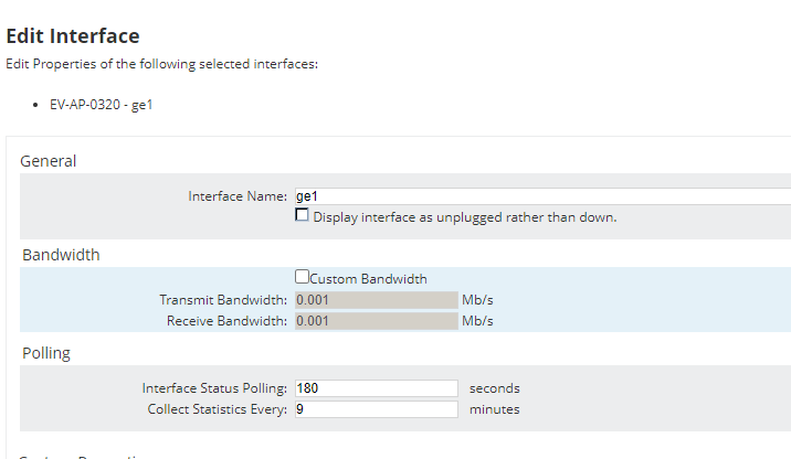

upon going to one of AP nodes and going to interface 'GE1' (main link to switch) it has a transmit and receive bandwidth numbers as '0.001Mbps' and are set to grey (screen grab below). You can override the numbers by ticking a box, however I need to set this to all APs. There must be a global/group policy / setting applying the '0.001Mpbs'. All Aps can handle 1GBps on their GE interface.
Can anyone advise where I could locate/find the policy applying the low bandwidth numbers?
