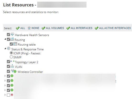

I would like to disable the Wireless Controller resource from all devices with the manufacturer Fortinet. How can this be done?
I don't have the exact devices you mentioned, but do you see the Wireless controller listed when you look at List Resources? If that is there removing it should keep it off unless it gets re-addded manually or from automated import from Network discovery. If you have too many devices for manual clean up, it might be possible via SWQL but I don't have any sample code that would help. If we need to, we can try working through it.
Yes. I was looking for a bulk alternative as I have 242 devices and growing that I need to disable this resource on.

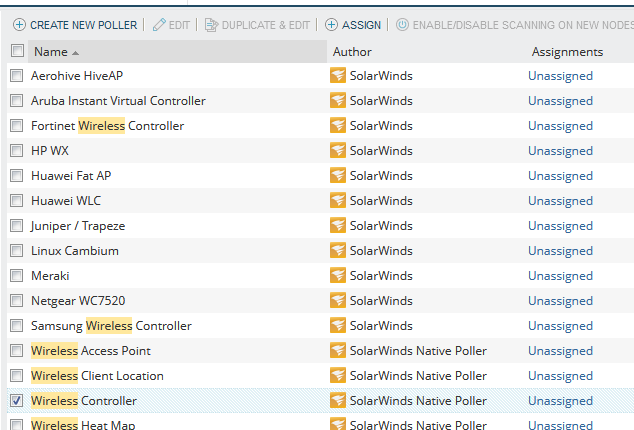

You should be able to use the Manage Pollers page to do this.
