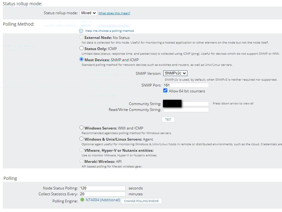

My device is configured for polling for statistics every 20mins as you can see on it's properties:

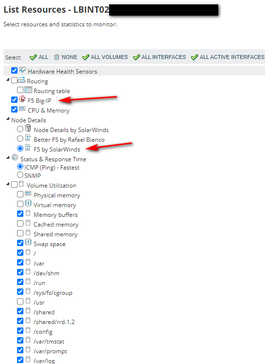

So my understandig is that every 20min, my polling engine is going to my F5 device and poll statistics. As you can see, under "list resources", my F5 device is collecting node details.
So again, I would thought that every 20mins, Solarwinds is polling my F5 device.

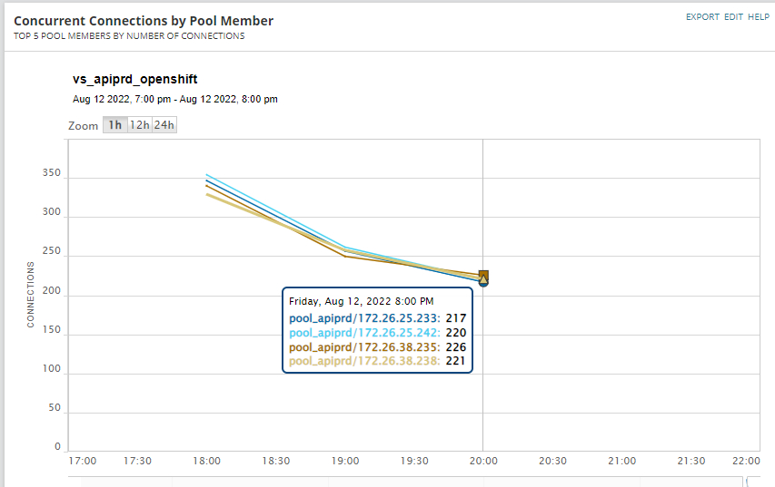

BUT, when I go to my pool graphs, I only see plots (sample rates) every 1 hour, like this:

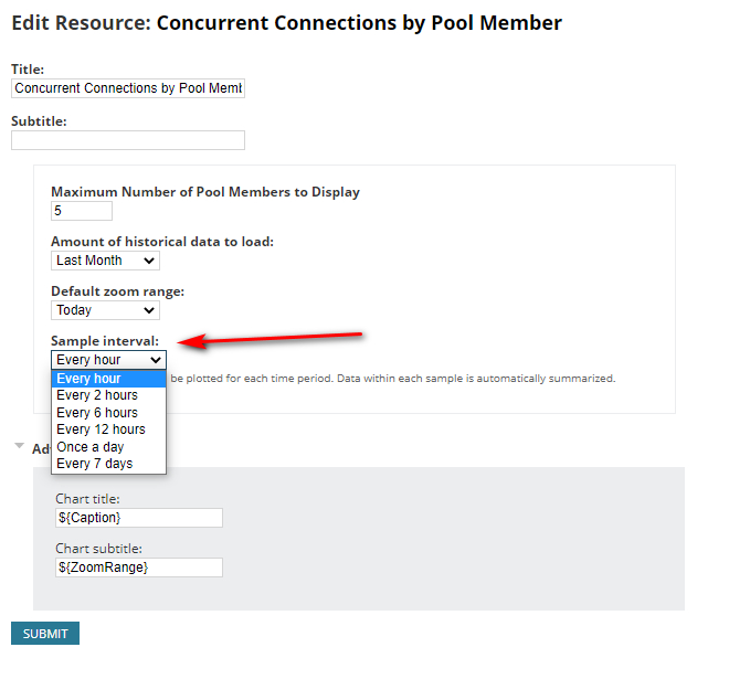

I tryed changing my polling to 5min or 10 minutes, but that doesn't affect my graphs. And if I edit the "Concurrent Connections by Pool Member" widget, I only see these options:
So how bad is it? I didn't find how to adjust this sample rate anywhere!
