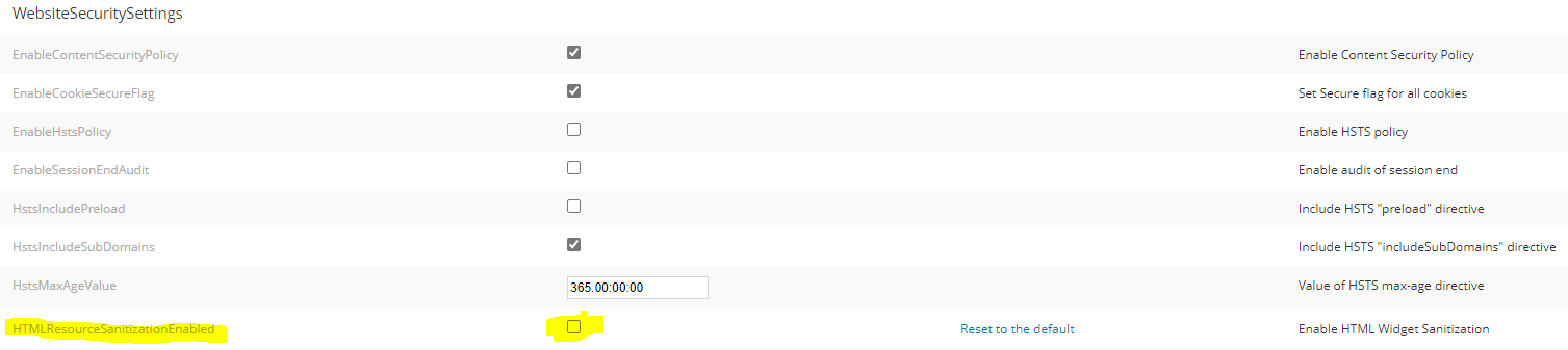

Should you decide to try the Custom HTML widget there is a security setting you may need to adjust. Read up on it before changing it so you know the security risk.
You will need to access to the Advanced Configuration page which is this URL, replacing the words in caps with your server name.
https://YOURORIONSERVERNAMEHERE/Orion/Admin/AdvancedConfiguration/Global.aspx
Then disable this checkbox
Then your page will load correctly.
