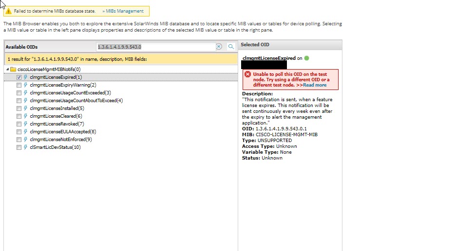

I'm trying to create a UnDP for OID 1.3.6.1.4.1.9.9.543. Based on this OID being polled. I want to create an alert based on the response for OID's 1.3.6.1.4.1.9.9.543.0.1 too .14 . However when using UnDP, I get the OID's are not supported.
When using MIB Browser, the OID's appear to be Traps. I cannot find a symbol key. But I think, UnDp is showing these are traps.
Does this mean I cannot poll for the OID's and have to have the device send the trap?
