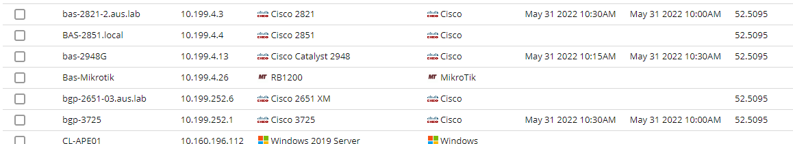

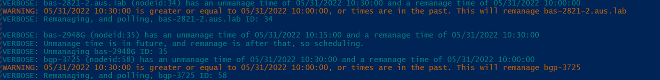

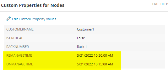

The logic is fairly simple, set the time (in UTC), as custom properties. When the script runs it picks up that data. If the unmanage time is in the future, and sooner than the remanage, it will call the function to schedule. Otherwise, it will just remanage the node.
So in my example here, there is one node (the 2948) that will be unmanaged, and the others have a remanage time before the unmanage, so those will just remanage.

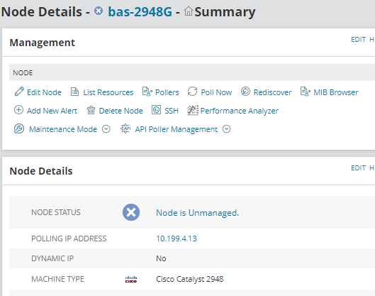

The time will be displayed on the node details page (note the time here is the local time, not UTC)
And when the time is matched it will then unmanage, and of course remanage after.
