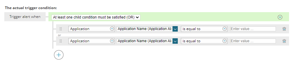

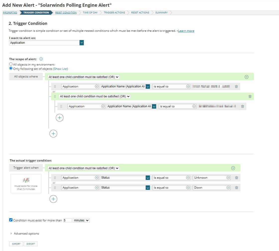

We had an issue yesterday with our APE engine that caused it to freeze up and we had to give it a reboot for it to come back. We found out that there were 7 nodes that could not fully contact the APE and these 7 nodes keep reaching out and could not fully connect and it caused the APE to stop functioning. I have both the MPE and APE SAM applied to both nodes and am setting up an alert for both of these. I am a little rusty with alerting so hoping someone can check my logic here to make sure it is sane.
