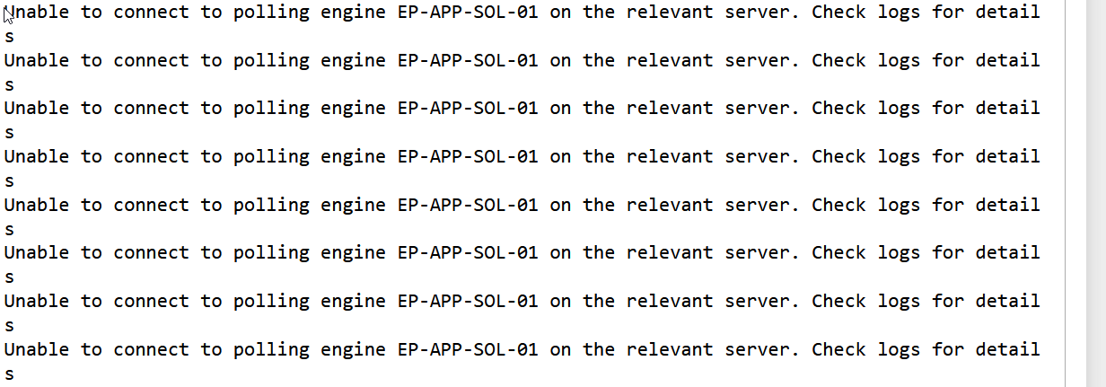

i have an issue when i try to run the sample code from the orionsdk-python in particular from this page:https://github.com/solarwinds/orionsdk-python/blob/master/samples/ncm_execute_script.py

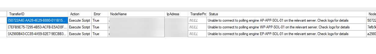

i get this error unable to connect to polling engine, we have 3 pollers, i tried all 3 pollers its the same result
here is the code i am using with slight editing
