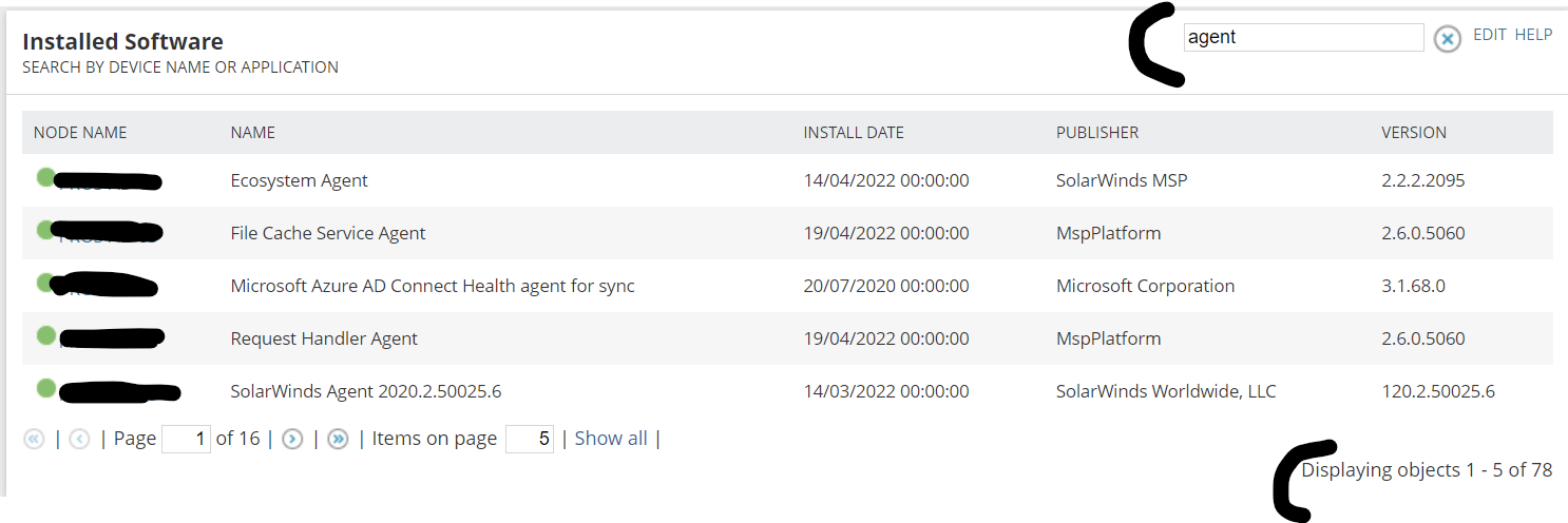

I'm using this in the where statement feel like there should be another variable?
WHERE s.Polling.Node.Caption LIKE '%${SEARCH_STRING}%' OR s.Name LIKE '%${SEARCH_STRING}%'

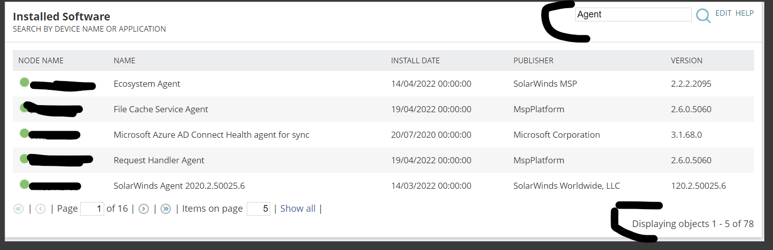

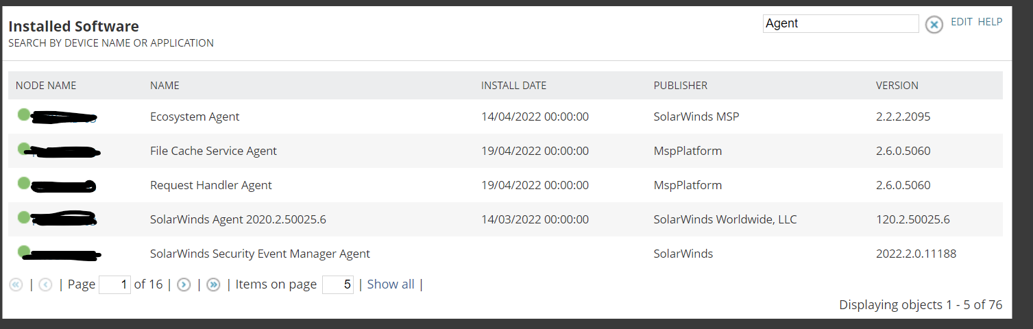

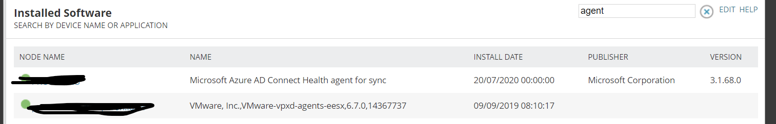

That's strange I didn't think the LIKE keyword was case sensitive... mind sharing the query? I'll see if I get the same behaviour and mess with it a bit.
I've never seen the search box be case-sensitive like that. I think it depends on your SQL collation as SWQL queries are converted to SQL.
Unless I'm misreading the question and you want the search to be case-sensitive?
So this was the search query
SELECTs.Polling.Node.Caption as [Node Name],'/Orion/images/StatusIcons/small-' + ToString(s.Polling.Node.StatusIcon) AS [_IconFor_Node Name], s.Polling.Node.DetailsUrl AS [_LinkFor_Node Name],s.Name, s.InstallDate as [Install Date], s.Publisher, s.VersionFROM Orion.AssetInventory.Software sWHERE s.Polling.Node.Caption LIKE '%${SEARCH_STRING}%' OR s.Name LIKE '%${SEARCH_STRING}%'
