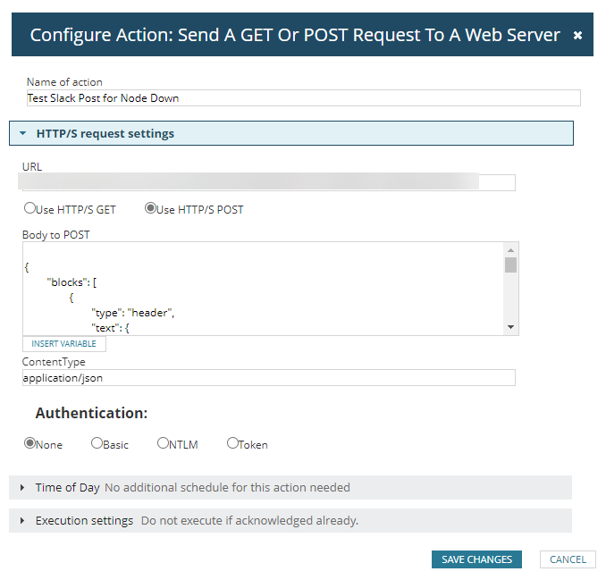

I set up an alert and tested it with the "Send a Get or POST Request to a Web Server" action.
If you need a webhook URL, read over Incoming webhooks for Slack and that process will get you the URL.
Since I had one already to a test channel, I started to configure my alert.
Like anything you name it, and the first line for URL is that webhook address. Use the Post action, and you get a body to post into. We will talk about that in a minute. Slack rolls all the authentication into that URL, so you won't need that, but you do need to set the ContentType to: application/json which allows the receiving end to know how to parse it. If you want stronger authentication , you likely want to read up on making a Slack Application, we won't dig deeper here.
At this point, I want to know that I can get data to slack, so I start with simple messages. Most of what I tested came from their documentation, I just copied the payload in, and made the Node down alert trip.
My first body to post was below, you want everything including the curly brackets.
{"text": "A very important thing has occurred! for details!"}

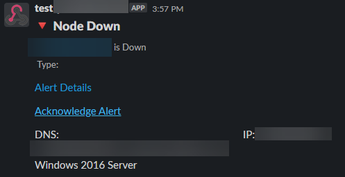

It looks like this in slack:
Its blurred out but the server name is a link too. I grabbed the basic data from my email alert and put it right in. Just treat the Macro's from the "Insert Variable" button in the Orion alert as the text that would be there later. I didn't have to edit it at all.
