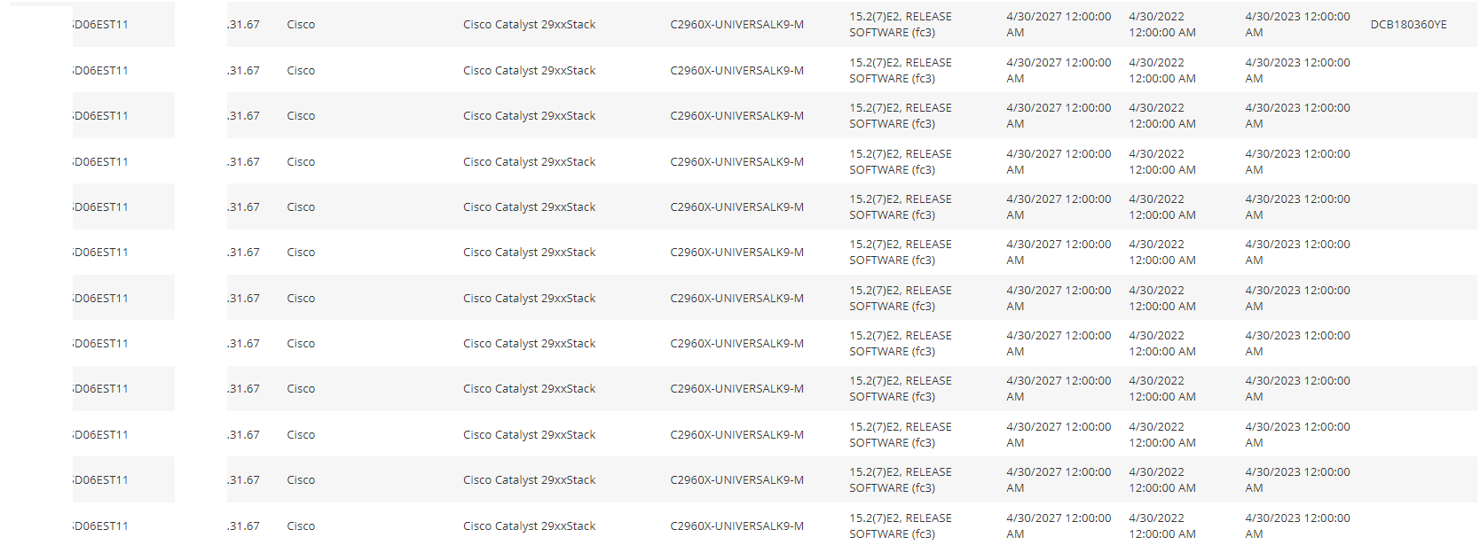

thanks, sample output. It will list the device several times.
Thanks @m_roberts. That was obviously a bad edit considering I don't have any matching data at all in my lab and I was trying to remember the linkages.
