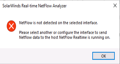

I have Flexible Netflow configured on a Cisco ASR-920 and though I am able to see the device on the Realtime NetFlow Analyzer, I am not able to collect the NetFlow data. When I try, I get the error message below. The result is the same whether I use Netflow or Flexible Netflow.
