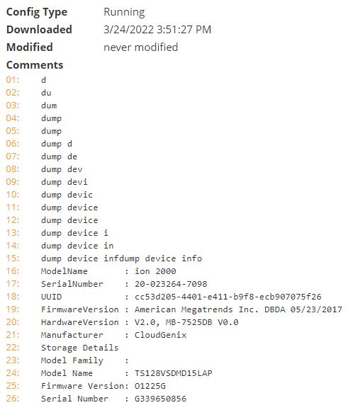

I'm trying to develop a simple template that will allow us to download configuration sections of our ION 2 and 3K devices. (Since there is no equivalent to "show running-config," thanks Palo:7)
Here's what I have so far, just to test with:

Here's what's being returned:
I've played with the ${IgnoreEcho} variable like this, but, didn't help:
<Command Name="DownloadConfig" Value="dump device info${IgnoreEcho}" />
Has anyone run into this before?
